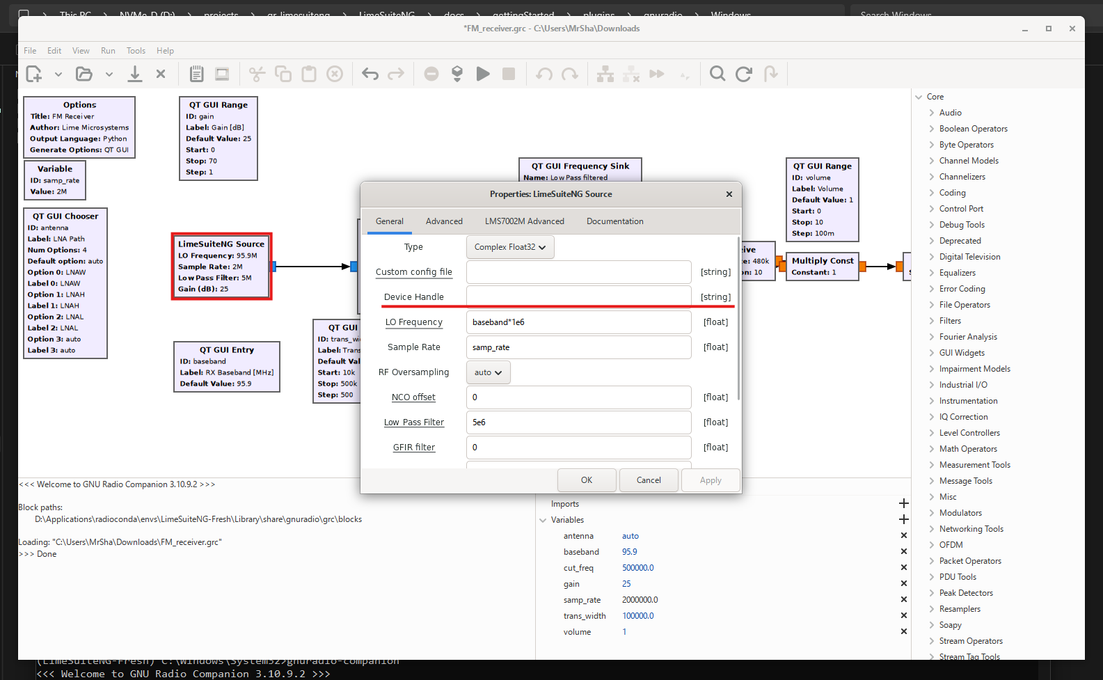

Plug in your LimeSDR device(s) into USB port. If multiple LimeSDR devices are pluged in, execute the following command in an active conda environment (or in linux terminal) to retrieve required SDR device serial number:
(LimeSuiteNG) D:\LimeSuiteNG\plugins\gr-limesuiteng>limedevice
Found 1 device(s) :
0: LimeSDR Mini, media=USB 3.0, addr=0403:601f, serial=1D9EFA3E84B944
1: LimeSDR-USB, media=USB 3.0, addr=1d50:6108, serial=00090706024F2403
Launch gnuradio in conda environment (or in linux terminal) by executing the following command:
(LimeSuiteNG) D:\LimeSuiteNG\plugins\gr-limesuiteng>gnuradio-companion FM_receiver.grc
Note
If the FM_receiver.grc
does not open when launching GNURadio, open example from one of the following directories: <repo root>\plugin\gr-limesuiteng\examples
, <radioconda install dir>\envs\<your env>\Library\share\gnuradio\examples\limesuiteng
(on Windows) or /usr/local/share/gnuradio/examples/limesuiteng
(on Linux).
If a single LimeSDR device is pluged in, run the example by pressing the play button. The software will automatically detect the LimeSDR device and use it to run the example. If multiple LimeSDR devices are present, to run the example you must enter serial number of appropriate LimeSDR device as shown in figure below.
